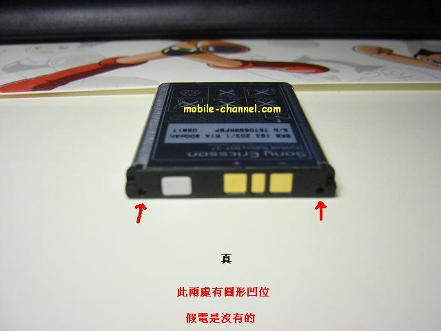

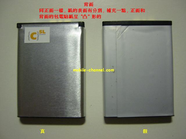

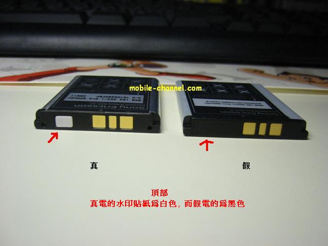

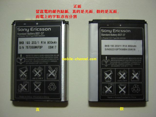

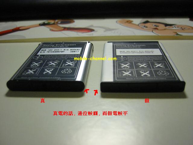

估唔到咁快會有假電流出呢 ~ 但唔怕 !! 我依家教你點分真偽  :wink:
(因有關圖片我存放在MC那面, 故圖片上會有MC的字樣, 請不要介意)

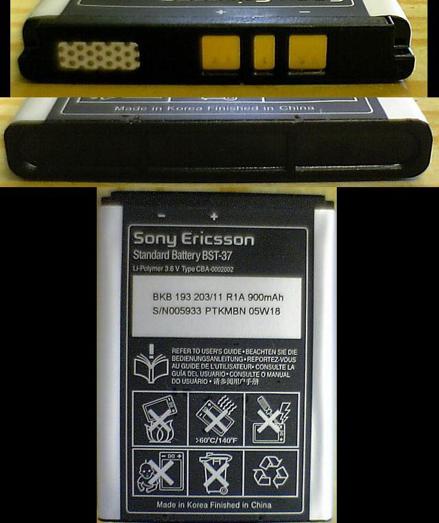

我粒電...同你講o既假電特徵吻合, 差在水印貼紙有黑點, 但確實o係peoples買woh :x

the battery come with phone ge~ I think 假電 must copy from the original la..
your battery marked type CBA-0002001, mine is CBA-0002002, may be different log ja :?

睇上下有無果d位..貼紙不能作準

吾駛怕..我粒w550i電同你一樣...
我拎過上SECS..佢地話係真電...而且佢地而家出左張MEMO教人分辨電池真偽..
你果張水印紙有點...係真電...
SECS話D水印紙上面D點仲有一個用途...就係證明係行貨...
放心... :lol:

甘又吾係...電池"CBA-0002002"係瓦面...電池"CBA-0002001"係光面...
同埋睇水印紙...瓦面吾一定係假...
睇下SE出果張MEMO LO...
SE 話好多人用緊假電拎部機上CS =.="
:lol:

直接睇Sony Ericsson個"E"字...
假電係直角...真電係圓角
