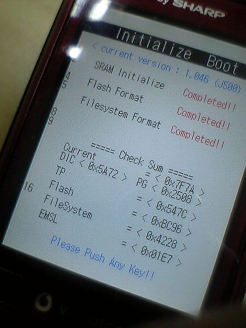

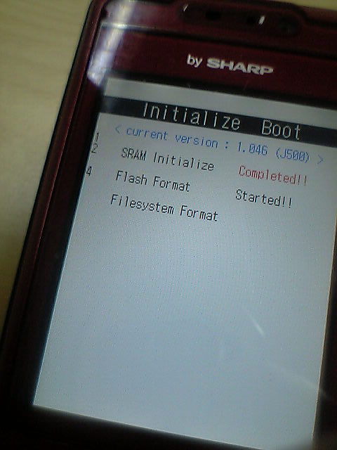

after #+ power on dim ah? it says sram intilize completed flash format started filesystem format? and it doesnt seem like moving wor...

thx thx ah kenny gor it works now...

It will take some time... Attached is some screen shot.
