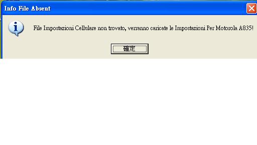

unfortunately another problem has occur in the LeaderGL FlexEditor
it show an error message although i've update it
pls help!!

Yes, I do get the same problem and do not know how to solve it!

Have to change the model to V3X (H3G) .... and this message will gone !

um...can explain more detail ok??
