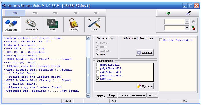

Hi Kenny,
Today, I want to use NSS to change the product code of my 6234 and upgrading it with chinese interface. When I use the NSS, it cannot find my 6234 even I press SCAN button, it shows error. Then, I saw the texts on left dialog box showing:-
" ->Products Dir('products').......Not Found."
Can you teach me how to fix this problem? Thank you very much! :D
NSS.JPG [ 70.14 KiB | 被瀏覽 8042 次 ]

最新版本既 NSU USB Driver 唔兼容 NSS。

係喎 ....... 之前 Kenny 谷 都有兄弟報告過 ......... 要用舊版 NSU 先得 ;)

So I need to install NSS USB driver separately, right? Thanks

個人建議你 Uninstall 左個 NSU 然後再用 NSS 改 Code 比較好。
又或者如果你有兩部電腦,咪其中一部用黎改 Code,另一部行 NSU 囉。

OK... Will try to use NSS on another PC tonight! Thank you!~~

I hv successfully changed the product code last night but NSU still cannot recognise it is 6233. It shows it is 6234. I think it is because of the product type is still RM-123 not RM-145(6233). I hv tried to use NSS to change this but seems NSS does not hv this function...... Do u know any other method? :)
