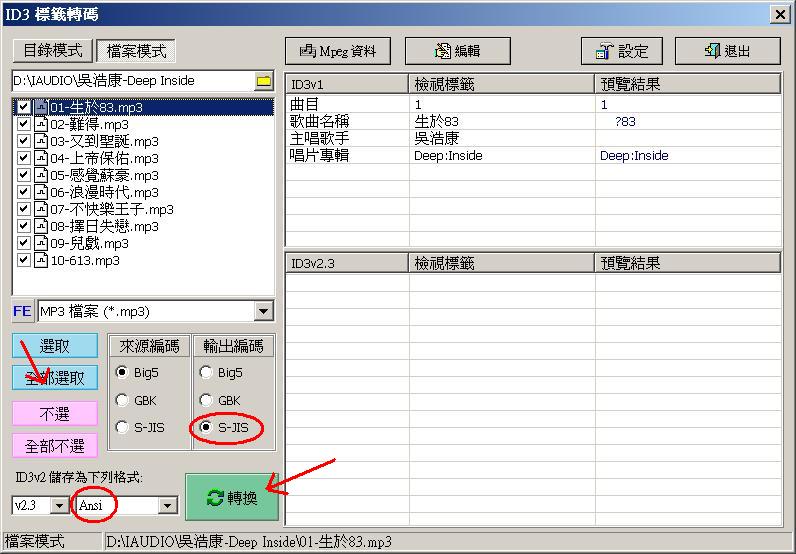

1. 行 ConvertZ , 把MP3的ID-tag由原來的中文(BIG5/GB) 變成"日文"
1.1 行 ConvertZ 後 , System tray/系統列上將出現齒輪 icon, 代表已運行.
1.2 把mouse pointer移到畫面最上方 , 出現ConvertZ的Toolbar , 按下右上方的[ID3]鍵 , 出現 <ID3標籤轉碼> 程式.
1.3 選取需要轉換的 MP3 檔案 , 來源編碼[由得佢 , Default應該detect到你本身IDtag中的內碼] , 輸出編碼 [S-JIS] , ID3v2[V2.3+Ansi].
1.4 勾選所有需要轉換的 MP3 檔案 , 按下<轉換>鍵一次過把所選的進行轉換工序.

like this ??
檔案註釋: FREEWARE
convertz801.zip [771.47 KiB]
被下載 319 次
step-05.JPG [ 91.55 KiB | 被瀏覽 3999 次 ]

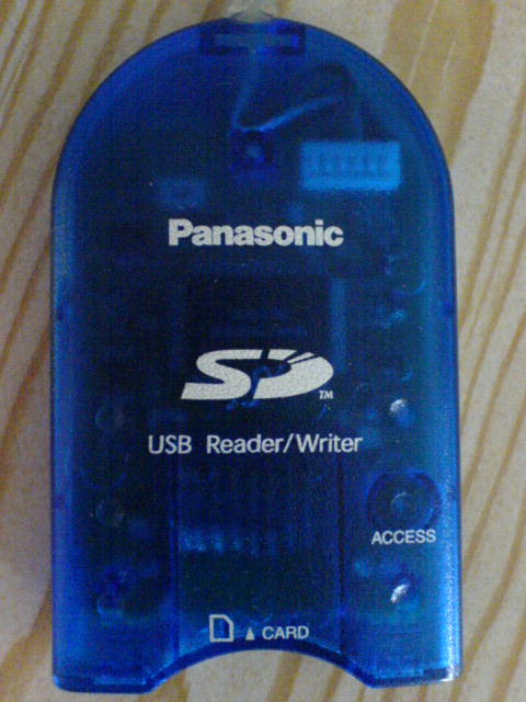

I would like to ask :
transfer mp3s with Chinese titles and artist names, a new model of Pan. band card reader is a must ??
Coz I'm using the following card reader, and the result not work...
Anyone can help ?

NO, I don't think so! If your OLD panasonic card writer/reader can transfer MP3 with English Text via SD-Jukebox, then it should work for Chinese too.
@market 寫:
Anyone can help ?

willy 寫:
..... can't transfer any text. English also :cry:
