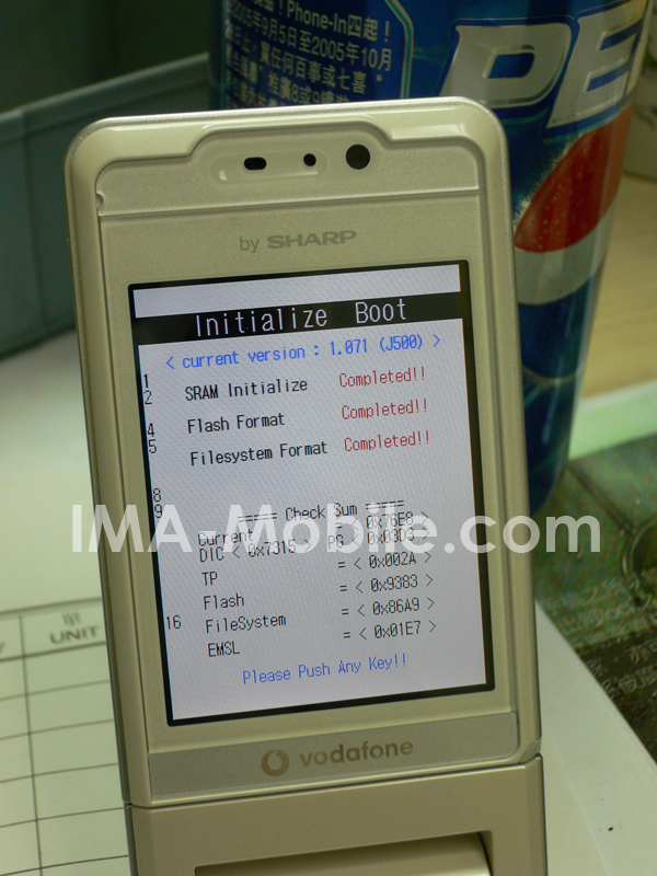

文章發表於 : 週五 10月 21, 2005 3:24 am
1) Switch off the phone
2) Press # + Power and switch on the phone again
3) The phone will format itself, and will take 10-15 minutes
4) When you see the Blue words saying "Press any key to continue", than press any key. The phone will switch off
5) Take off battery and put it back and switch in the phone
6) Phone will be locked again!
唔明唔緊要,睇埋張相就會明!
:-P
Format.jpg [ 482.44 KiB | 被瀏覽 2535 次 ]
